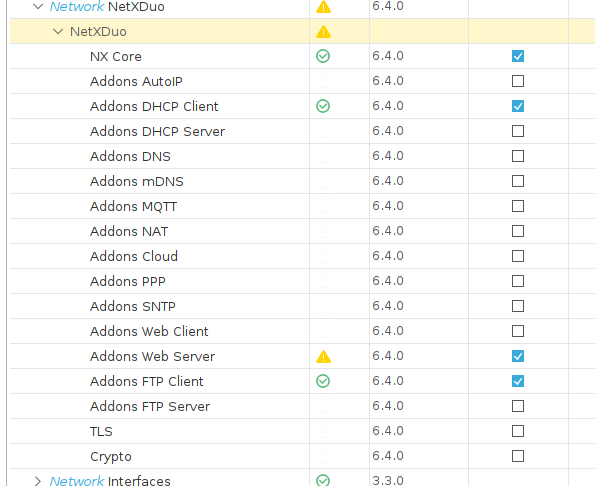

Compared to the available addons on NETXDUO GitHub, there are less addons available in CubeMX, as you can see in the screenshot:
by now, i only need the TFTP.
thank you
