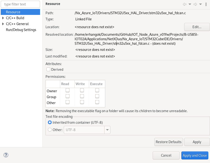

I am working on X-CUBE-AZURE in B-U585I-IOT02A board. My IDE version is 1.18 and i am using Fedora 41. When i enable FDCAN peripheral in CubeMX it places the stm32u5xx_hal_fdcan.c and .h file into the X-CUBE-AZURE/Drivers/STM32U5xx_HAL_Driver/Src. Even though it places the correct .c and .h files the build fails when i enable FDCAN from CubeMX. Here is the build error message.
/home/erhangok/Documents/GitHub/IOT_Node_Azure_v01fw/Projects/B-U585I-IOT02A/Applications/NetXDuo/Nx_Azure_IoT/Core/Src/main.c:357:(.text.MX_FDCAN1_Init+0x72): undefined reference to `HAL_FDCAN_Init'
collect2: error: ld returned 1 exit status
make: *** [makefile:104: Nx_Azure_IoT.elf] Error 1
"make -j8 all" terminated with exit code 2. Build might be incomplete.
15:41:47 Build Failed. 2 errors, 478 warnings. (took 19s.801ms)Even though the file exists in Drivers/STM32U5xx_HAL_Driver it still cannot find it. When i look further into this i saw that subdir.mk file does not contain this line: "./Drivers/STM32U5xx_HAL_Driver/stm32u5xx_hal_fdcan.o \". Furthermore in the project explorer tab -> stm32u5xx_hal_fdcan.c -> Properties, it says the location does not exist and the resolved location points in the wrong location. Instead it points to "/Projects/B-U585I-IOT02A/Applications/NetXDuo/Nx_Azure_IoT/STM32CubeIDE/Drivers/STM32U5xx_HAL_Driver/stm32u5xx_hal_fdcan.c - (does not exist)" which the folder is empty. I do not quite understand the structure of this project since it is a nested project. There are two Drivers and Middlewares folders in the project, one is in the main location of the project and the other one is inside Projects/B-U585I-IOT02A/Applications/NetXDuo/Nx_Azure_IoT/STM32CubeIDE/Debug/Drivers/. I found out about this while the comparing the subdir.mk makefile in Windows build and Fedora build. This project builds successfully when FDCAN is enabled through CubeMX.
Can someone help me about this problem? I could change the file location manually but i believe the same problem will occur again if i enable another peripheral and it will still point to the wrong location thus it will not build and fail.

I manually added the file as a linked file. Project Explorer -> STM32U5xx_HAL_Driver -> New -> File -> Advanced -> Enable tick for "Link to file in the file system" and wrote the relative path as PROJECT_LOC/../../../../../../Drivers/STM32U5xx_HAL_Driver/Src/stm32u5xx_hal_flash_ex.c which solved the problem for now.
