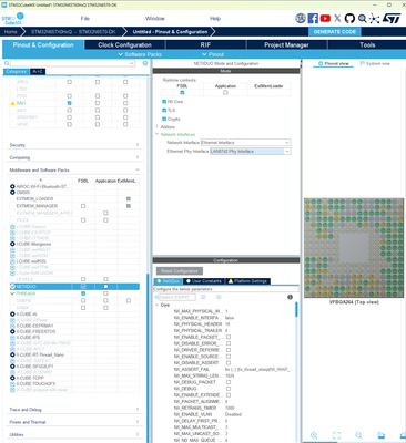

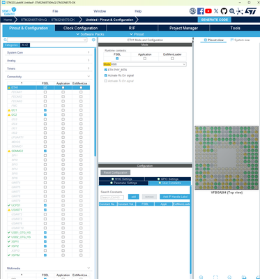

I am trying to do tcp client application with stm32n6570-dk board and when I select RGMII mode in ETH1, ethernet interface is grayed out in network interface settings in netxduo. How can I fix it?
Cube IDE versiyon is 1.19.0, CubeMX version is 6.15.0 -RC7.

Hello @erik71
I suggest you to put the cursor on the greyed option (ethernet interface under network interface settings in netxduo). A pop-up message should tell you why this option is not available and what to do to make it available again if this is possible.
Best Regards.
II
2025-10-26 7:19 AM
Hello @Issamos
In the pop-up message "Ethernet Interface Disabled: Active only if ETH IP is enabled." is written. What does ETH IP mean? I am configuring ETH1 as RGMII mode.
Thank you for your answer.

2025-10-27 1:12 AM
Hello @Ghofrane GSOURI
I'm using the STM32N6570-DK board. This board supports 1GB Ethernet, so I need to configure RGMII.
I need help this.
Thank you for your reply
2025-10-27 1:25 AM
Hello @erik71
I confirm that this is a current limitation. An internal ticket (ID: 217238) has been raised and escalated to the development team for further investigation and resolution.
