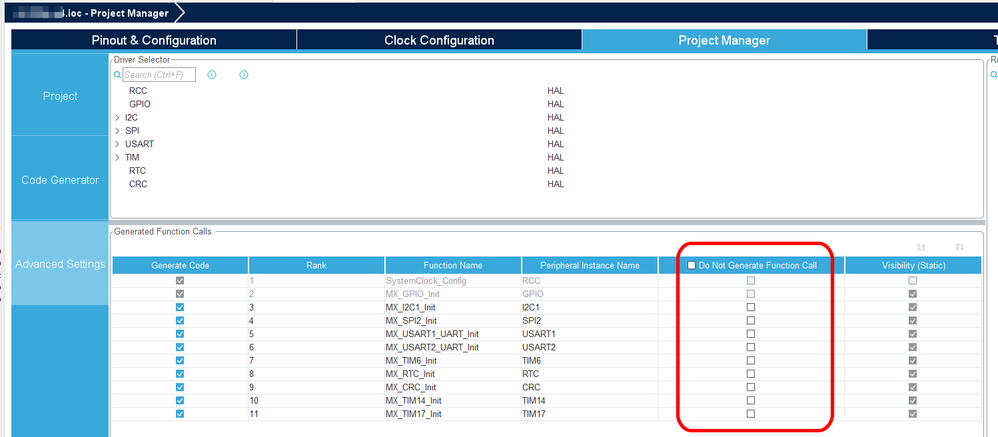

I think it's a common scenario to have (at least some) peripherals which are not enabled until needed?
Or, perhaps, just configured at start-up, but not enabled until actually needed.
eg, an RTC alarm.
But CubeMX doesn't seem to support this:
Or have I missed something/?

STM2CubeMX Project Manager Advanced Settings has "Do not generate function call" options for the various _Init functions.
hth
KnarfB
hth
KnarfB
2025-01-14 6:33 AM - edited 2025-04-01 8:23 AM
Ah yes - that's it!
Although, in the specific case of the RTC alarm, it still just creates one MX_RTC_Init function - whereas I'd have thought it more likely that you'd want to configure and start the RTC itself separately from setting an alarm?
