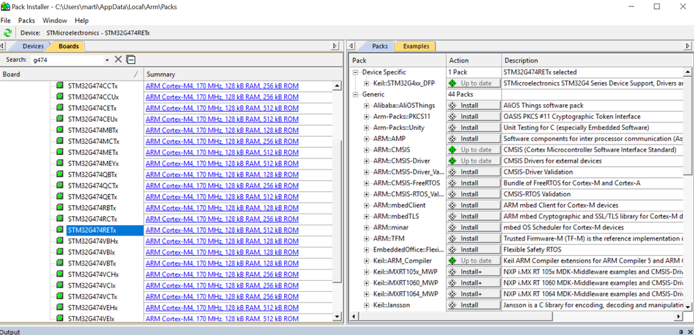

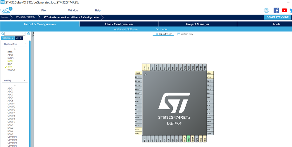

Hello, did you receive the ioc file? I have the same issue in G473 in Keil, where the Cube generated code won't compile in stm32g4xx_ll_fmc.c until I uncomment the line with #define HAL_SRAM_MODULE_ENABLED in the stm32g4xx_hal_conf.h header.
2020-01-16 8:22 AM
Hello @Andreja Kostic , no ! could you please share yours ?
Did you create a project from CubemX then generated code on Keil , when building did you find errors ? please give me more details .
Thanks,
Khouloud
2020-01-22 1:46 AM
Hello @Khouloud ZEMMELI, sorry for the delay. I sent a description of the issue and few problematic files to you via private message.
Unfortunately, I forgot to mention tool versions.
I used STM32CubeMX version 5.5.0.
The Keil versions are:
µVision V5.29.0.0
C Compiler: Armcc.exe V5.06 update 6 (build 750)
Assembler: Armasm.exe V5.06 update 6 (build 750)
Linker/Locator: ArmLink.exe V5.06 update 6 (build 750)
Library Manager: ArmAr.exe V5.06 update 6 (build 750)
Hex Converter: FromElf.exe V5.06 update 6 (build 750)
CPU DLL: SARMCM3.DLL V5.29.0.0
Dialog DLL: TCM.DLL V1.36.5.0
Target DLL: UL2CM3.DLL V1.163.0.0
and the STM32G4XX_DFP is version 1.1.0.

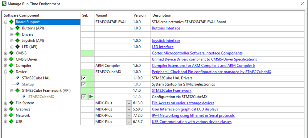

2020-10-28 11:18 AM
Hello everyone, I return to the topic. Has anyone found the source of this issue?
I am creating the project from scratch in Keil, then I add the STMCubeMx from the RTE administrator, without initializing any peripherals or modules, I just click on "Generate code". And I have the same issue with HAL_SRAM_MODULE_ENABLED.
Thanks!
