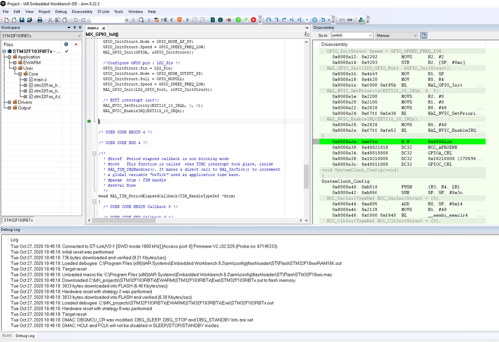

2020-10-20 1:38 AM
Hello
i'm using stm32f103rct.
Use cubemx and just set RCC,and SYS(JTAG, Timebase Systick)
compile with IAR and then download and debug press break.
Hard fault exception
help plz

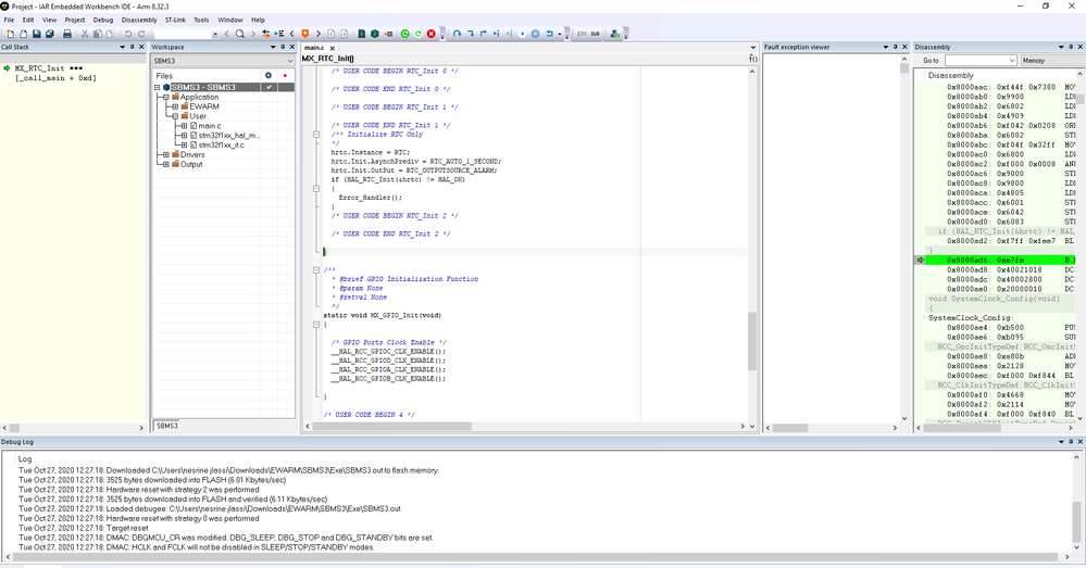

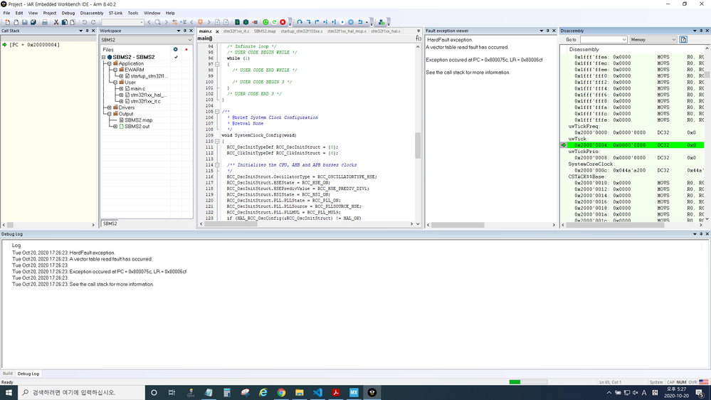

2020-10-26 9:52 PM
yes. we have two kind of board. they are very similar hw circuit.
use same mcu and the one use 8Mhz external clock and the other use 12Mhz external clock.
If you set the same using cubemx and only different HSE, 12Mhz works and 8Mhz does not.

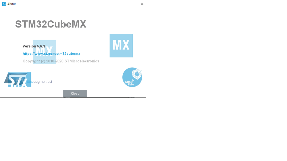

2020-10-27 2:52 AM
Could you please share you .ioc file to check with.
Please specify you STM32CubeMX version.
2020-10-27 3:08 AM
2020-10-27 5:30 AM
No issue detected when using STM32CubeMX v 6.0.1.

2020-10-27 6:43 PM
I have incorrectly connected the BOOT0 PIN.
Thanks a lot.
