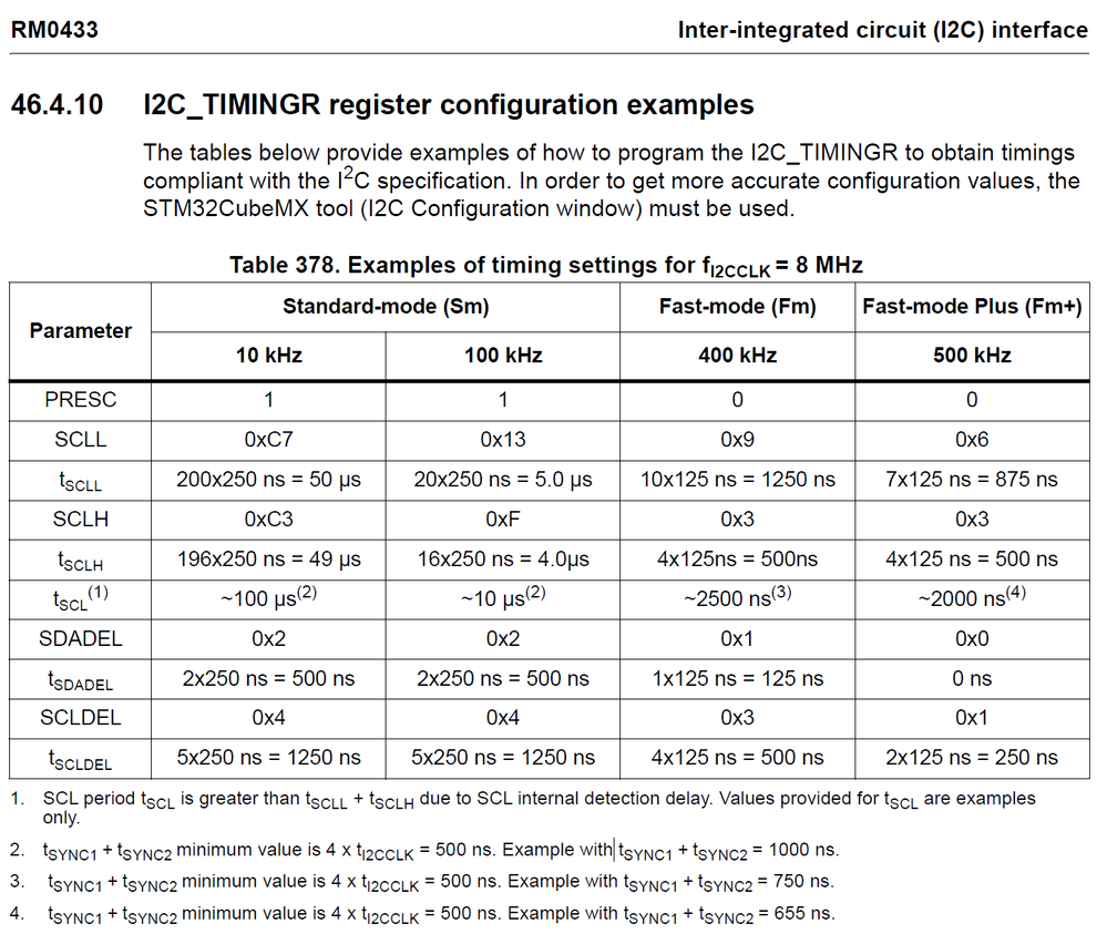

Chip number is STM32H743ZIT6U.
I just want to know the direct conversion formulas of Timing to Hertz, if you can please.
2021-10-25 6:21 AM
Did you look in the reference manual?
