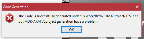

I' upgrade my CubeMX software to V.4.25.1 every thing is clear no problem. But when we try to generate MDK project CubeMX show an project generate problem ( see in attach pic.)
Please tellme how to fix it

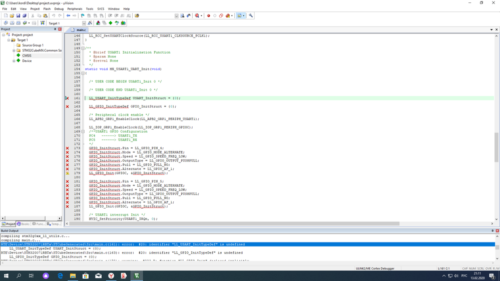

I tried everything described above nothing helps. Now I write under several microcontrollers nrf52, TI, Silicon labs. Nowhere was there such a situation(there were other ha ha:) but at least described solutions) and here in General it is somehow bad. I got to the point where keil opens a project using this manual https://www.keil.com/pack/doc/STM32Cube/General/html/cubemx_proj.html
and imports settings from CubeMx but writes the following errors
STM32G071RBT6 - Nucleo board (noBSP)
LL tried
HAL tried
Keil version 5.29.0.0
CubeMX 5.5.0
