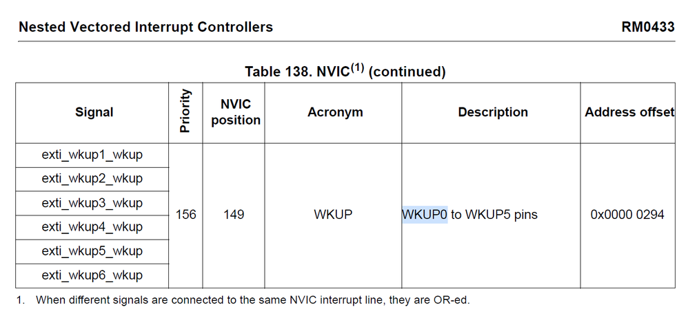

Please tell me why the wakeup pin numbers are shifted up by one in the HAL PWR lib?
If there is a legitimate reason for this mapping, then why is it not documented anywhere? I had to infer the mapping and test it by trial and error.

The reference manual lists wake up sources as 1-6 and pins as 0-5.
It is documented in the RM, but it would be less confusing if they shared the same numeric base as they do for other interrupt sources. It's also unclear to the CubeMX user what "Wake-up 0" means.

I'm waking from Standby, not firing an interrupt. Is the information on the NVIC even directly relevant?
The HAL PWR library only refers to pins. "PWR_WAKEUP_PIN4", "HAL_PWR_DisableWakeUpPin()" etc. This is misleading as these defines and functions actually refer to what? Signals? The HAL docs seem to be machine generated and do not say.
I found a few blog posts with examples of how to do it and even ST's example code. Nowhere was there any mention of this little twist.
