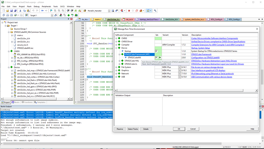

I am using Keil MDK to setup a project for STM32 devices. STM32cubemx is integrated into Keil and can be used to generate a skeleton for the project (main.c, stm32XX.c, .h files and stm32CubeMX.ioc, etc).
This is helpful but some of the generated code contain duplicates of some handlers, like "void PendSV_Handler(void)". How do I stop STM32CubeMX from generating these defines?

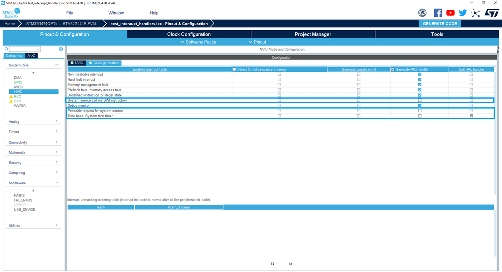

If I did understand well the situation; you need that CubeMx stop generating the interrupt handlers, you mentioned.
If so, under System Core --> NVIC --> Code generation you will find the list of all the interrupt handlers. You uncheck those you don't need CubeMx to generate:

I have the same problem here.
I use CubIDE 1.10.1 with integrated CubeMX 6.6.1 for STM32G474.
As @newdev wrote:
CubeMX is generating handler functions (in file "stm32g4xx_it.c") for
which collide with the handlers of "my" RTOS.
How can I prevent the generation of these functions in CubeMX?

2022-11-25 1:06 AM
This solved the issue. Thanks!
