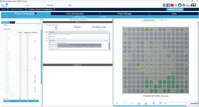

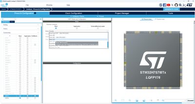

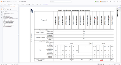

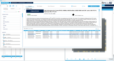

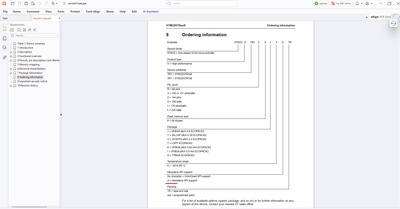

It's even bigger error in the STM32H7x7 LQFP176 since the XSPI1 and XSPI2 are available at HEXA_SPI, but it's the same behaviour as above. The right MCU cannot be selected. See the datasheet for the ordering number. It has to have H to get the HEXA SPI,but it is not supported by cubemx.

Ghofrane GSOURI
Hello @geriTricky

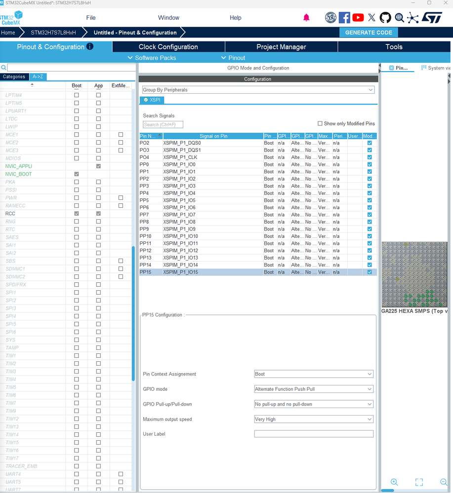

For STM32H7S7L8HxH:
When you enable XSPI Hexa mode in CubeMX, the tool correctly reserves the XSPI pins (PP2, PP3, PP4, PP11…PP15, etc.)XSPI1_Hexa.png
which are physically present on the HEXA package and listed in DS14359 Rev 6, Table 21.

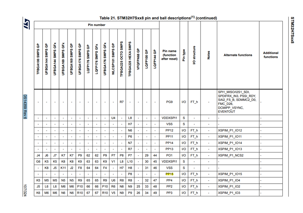

For STM32H7S7L8Hx:
Those XSPI pins (for example PP15 / XSPIM_P1_IO15) are not bonded on these packages (the corresponding column in Table 21 is empty).
Therefore, XSPI Hexa mode is physically not supported on STM32H7S7L8Hx .
THX
