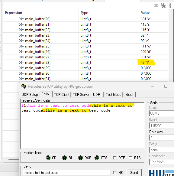

I used it, first it sent just one time then I also call it in HAL_UARTEx_RxEventCallback at the end. It work exactly what I want I meant when I send a data from UART1 it sends data back from UART6. However, when I send new data it writes it first byte and sends new data and the data I sent before it. I want to receive only last data. It receives 1 and then changes first byte of the data I sent before 1, and transmite them together.
I receive data with rx_buffer but store whole data sequentially in main_buffer. I tried to transmit both of them but nothing change.
HAL_UART_Transmit_DMA(&huart6,rx_buffer, sizeof(rx_buffer));
