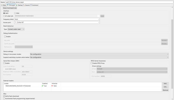

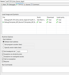

For more investigation, I suggest please that you provide the Debugger and the Startup configuration.
Thanks.
Mahmoud
JimEno
Associate III
Recommended info added. Tried to follow README.md file as best as I could.

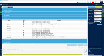

I was using the IDE to build and program the sample project. I assumed the IDE or MX would handle any settings or options. I did not assume I HAD to use the Programmer to set any options. I will try this and report back.
Thanks for your response Mahmoud.
JimEno
Associate III
Mahmoud,
I enabled that option byte as you suggested. It worked.
- User Option Bytes requirement (with STM32CubeProgrammer tool)
- XSPI2_HSLV=1 I/O XSPIM_P2 High speed option enabled
It seems like setting this option could have been done in the sample project
firmware. I shouldn't need the Programmer. Am I wrong?
I will consider this issue resolved. Thanks for your response.
Hello @JimEno
Further to your comment, the XSPI2_HSLV can be done by user code as described in RM0477 section 5.4.3 Option byte words modification / Changing option byte words. VDDIO_HSLV option bit is also required with XSPI2_HSLV.
The flash driver provides the following HAL API that can be used.
  * @brief  Program Option bytes.
  * @param  pOBInit pointer to an FLASH_OBInitStruct structure that
  *         contains the configuration information for the programming.
  * @note   To configure any option bytes, the option lock bit OPTLOCK must be
  *         cleared with the call of HAL_FLASH_OB_Unlock() function.
  * @note   New option bytes configuration will be taken into account in two cases:
  *         - after an option bytes launch through the call of HAL_FLASH_OB_Launch()
  *         - after a power reset (BOR reset or exit from Standby/Shutdown modes)
  * @retval HAL Status
HAL_StatusTypeDef HAL_FLASHEx_OBProgram(const FLASH_OBProgramInitTypeDef *pOBInit)
  • Note 1: This API will reset the device at the end to ensure the programming of the Option byte. To avoid a recall to the API after reset, you may need to test that the value of the option bit is not set before calling this API
  • Note2: Using CubeMx you need to insert this in the code for modifying HSLV option bit into the boot project, before any configuration of XSPI2.
Thanks.
