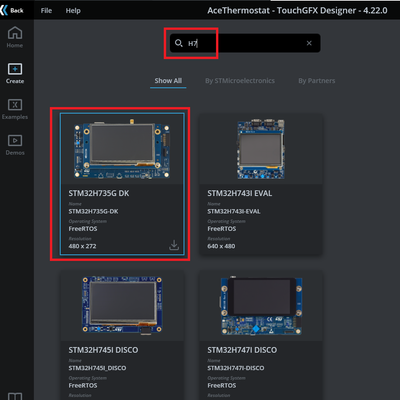

If I understand well, you're a newbie with TouchGFX. So I suggest you to start with a predefined board from TouchGFX designer as you are using H735G DK board. Starting from CubeMx is a bit complex and needs a knowledge to configure all the needed stuff CTOSPI interface, SDRAM, Framebuffer, LCD configuration etc ..:

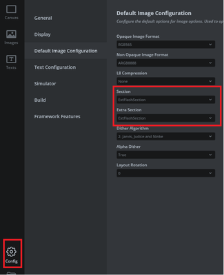

To relocate the TouchGFX assets in external Flash memory:

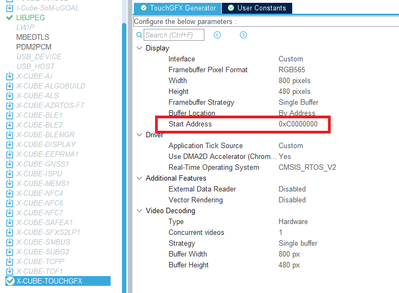

To set the SDRAM address for TouchGFX:
