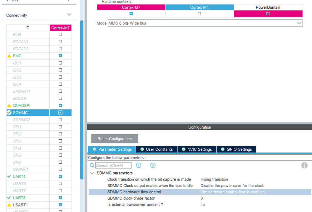

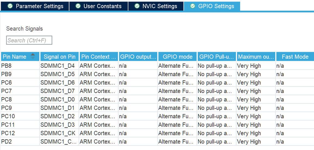

I have SDMMC1 configured for my H7 as follows:
The card is inserted. I call generated init, and set debug to the HAL_MMC_InitCard of stm32h7xx_hal_mmc.c file, line:
/* Identify card operating voltage */
errorstate = MMC_PowerON(hmmc);
if (errorstate != HAL_MMC_ERROR_NONE)
hmmc->State = HAL_MMC_STATE_READY;
hmmc->ErrorCode |= errorstate;
return HAL_ERROR;
}The errorstate is -1. What now?
The specific hardware is STM32H747I-DISCO board. I also tested it with hardware flow control disabled. Same result.
I switched the configuration to SDMMC_BUS_WIDE_1B and it works. At least it passes the initialization. I don't know how to interpret this behavior.
With the previous configuration you can see the QUADSPI module has a warning. The details say that some features are unavailable, but well, since they are not used (at least by me) - that should be fine, or that may be the cause of the problem?
