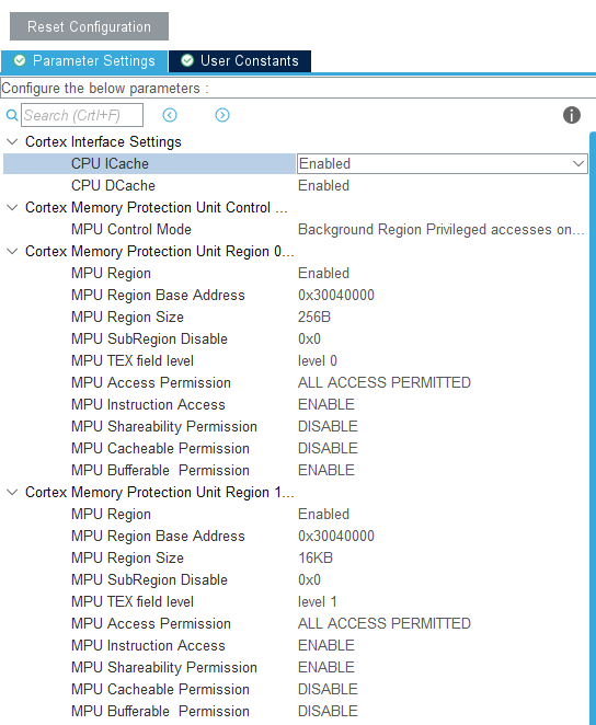

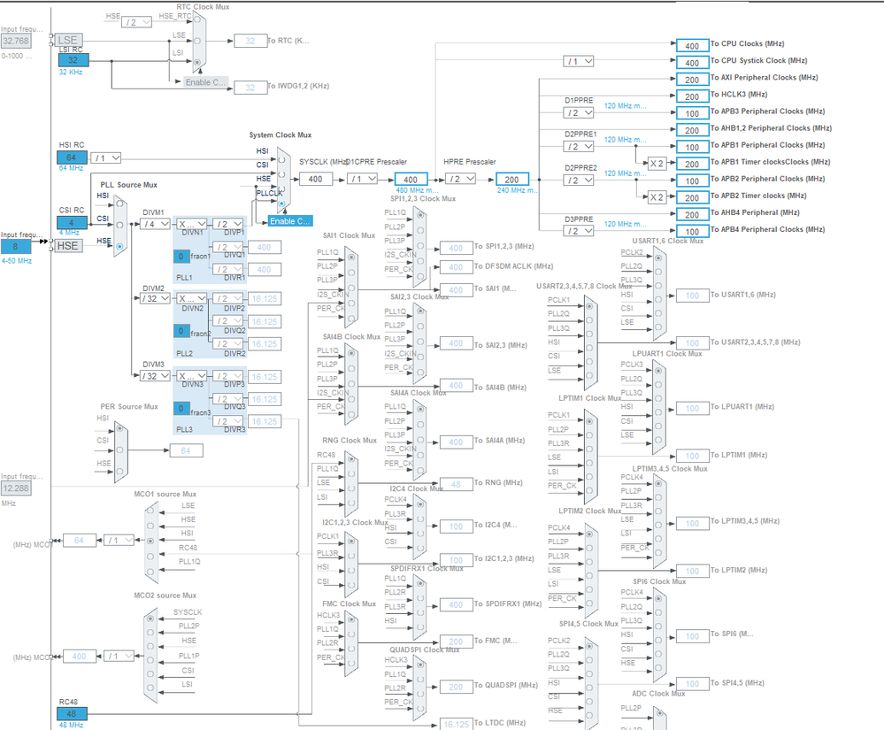

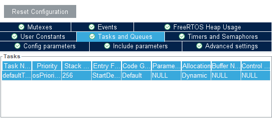

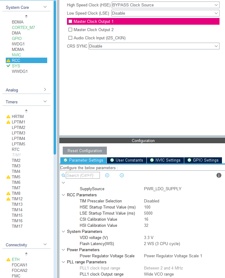

I followed the first example steps and I adapted some stuff based on what I found in the source files of the second example. However, I could not ping the board at all. I attached project files (Test_Ethernet).
Here are the steps that I've done (I attach snapshots at the end):
So what am I missing in my steps or configurations?
