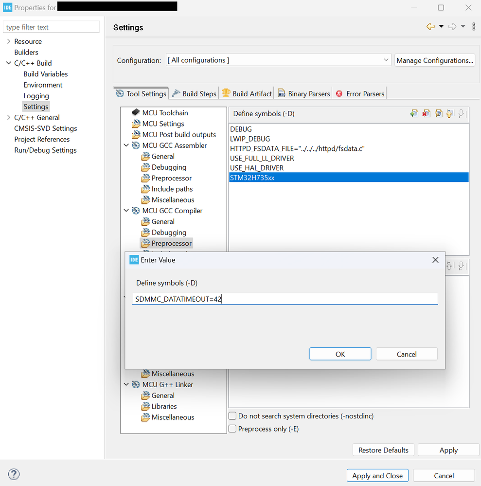

2024-05-22 5:57 AM - edited 2024-05-22 6:01 AM
You can simply add a global define to your build settings:
For SDMMC_CMDTIMEOUT it is more challenging. One solution is to include the c file in another c file and exclude the original c file from build. Then you can add some macros at the beginning and end of the source code without modifying the file. Or simply make a copy of the c file and rename it and then exclude the original from build.
