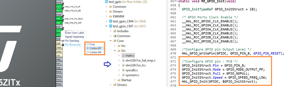

In fact, in the case of the stm32H7 Dual Core , when the pin is not linked to an IP that we have already started its activation by choosing on which cortex it is assigned, this pin remains free, i.e, it does not know on which cortex it is up to.
For its configuration to be correctly generated, you have to choose the cortex of this pin by right click on the pin, click on the Pin Reservation and then check one of the two cortex.
Once you generate your project, you will find the complete GPIO code in the /*Configure GPIO pin : PC8 */ section under main.c/MX_GPIO_Init function :) .

Thanks for the share of your ioc file which allowed me to know the main reason of the GPIO configuration code disappearance.

Thank you so much. That is the issue. I was looking for the pin assignment under the system gpio tabs. It wasn't in that setup. And I think it should be. Thank you once again.
