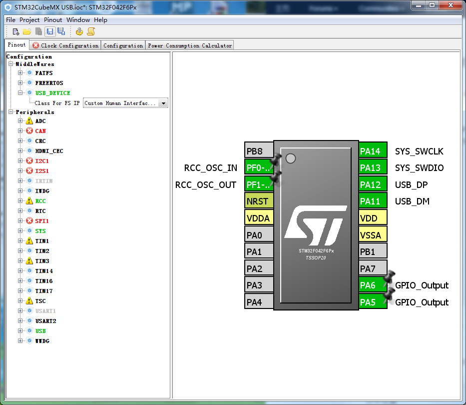

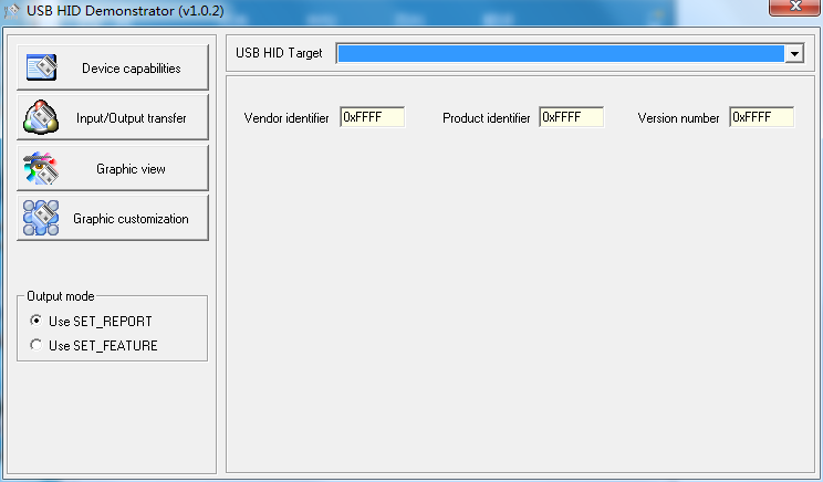

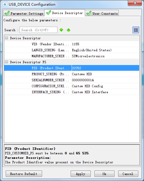

Hello everyone! I use CubeMX to generate projects for stm32f042f6 USB custom HID mode, when I configured parameters ,download to my circuit board,connect it to PC,but the USB HID Demonstrator do not display any message;
Configuration is as follows:
I wonder if the stm32f042 can realize this function of custom HID mode?

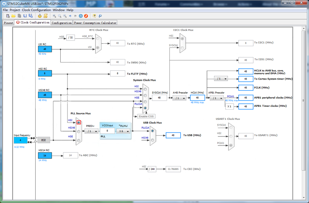

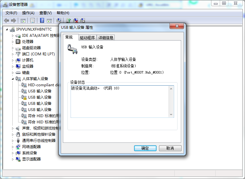

One thing I don't understand from your pictures is the clock tree configuration. You seem to have a crystal connected (from the GPIO view), why don't you use it as a clock source for the USB ? The USB needs a precise clock, so a crystal would be better than HSI. But you can also choose HSI48 as a clock source for the USB (and for the system if you like) and use the SOF event to recalibrate automatically the HSI48 at run time (this is what I did and it worked). Maybe the clock instability is why the device is showing with an exclamation mark on its icon. Can you tell us what is the error/warning message related to your device (right-click->properties) ?

After the USB device to connect the computer shows that the equipment cannot be started, the error code 10.What does this error mean?
When I try to use HSE will lead to my USB device shows unable to connect, so I just choose HSI.After listening to your advice, I will check for HSE issues first !
