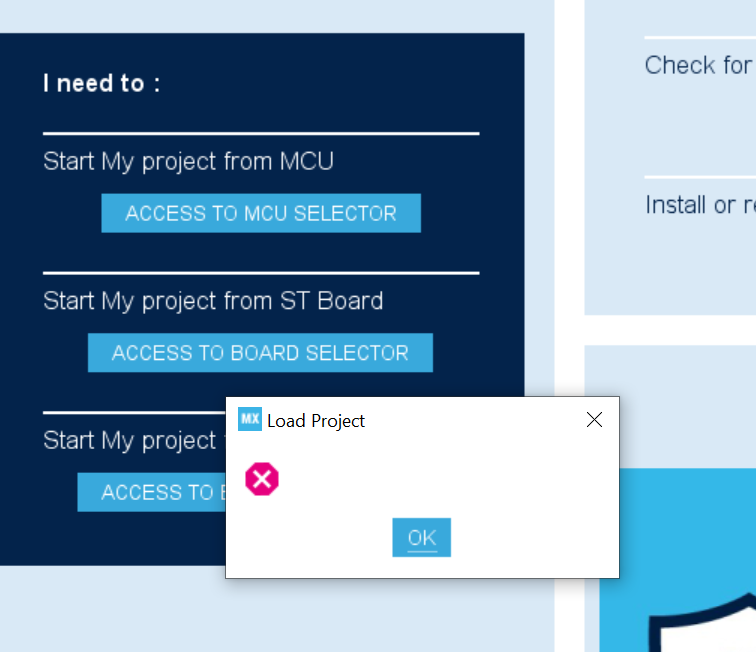

I am having a problem with CubeMX failing to load a project and not giving any description of what the error is. (See image)I started the exe using java to get more insight and I get this error

at java.awt.EventDispatchThread.run(Unknown Source)I have no problem loading any other project file. Also tested it on another machine and I get the same problem.
Any input would be greatly appreciated!
Samer

2021-02-23 3:56 AM
Hello @SKILA
Thanks for your feedback,
Could you please share your ioc file to check the problem from my side?
Khouloud
2021-02-23 3:59 AM
Thank you @Khouloud ZEMMELI I have sent you the ioc file in a message.
2021-02-24 7:50 AM
Hi @SKILA ,
You're right, I have reproduced the same issue using your ioc file (thanks for your help by sharing your project) and it will be fixed.
Always welcome, Khouloud
2021-02-24 7:57 AM
Hello @Khouloud ZEMMELI thank you for taking the time and looking at the file. I appreciate that it will be fixed but I would also like to be able to access this file now. Is there any thing I can do to be able to read the file and use it?
2021-02-26 7:07 AM
Hello @SKILA
Sorry for the delay, Issue is fixed and I can load your project now, could you please check with the latest CubeMX version (it's available on site ) ?
I'll be waiting for your feedback :)
Thanks, Khouloud
2021-02-26 8:25 AM
Hello @Khouloud ZEMMELI ,
I have now installed v6.20 but unfortunately, I still get the same empty error message :(
2021-03-01 6:43 AM
Hello @SKILA (Community Member)
I have made some changes to your project, please load the latest CubeAI pack (5.2.0) then re-configure it through CubeMX.
Please tell me if you still face a problem during the load of the ioc. (I have sent you your ioc file in message)
Thanks, Khouloud
2021-03-03 1:17 AM
Hi @SKILA ,
I'll share with our customers on community the steps that solved your problem:
1-Install the CubeMX 6.2.0 from site
2-Go to C:\Users\..\STM32Cube\Repository\Packs\STMicroelectronics on your PC
3-Delete the X-Cube-AI pack
Open CubeMX 6.2.0 version
4-Click on Manage Embedded software package under Help
5-Install X-Cube-AI pack VERSION 5.2.0 (latest one)
6-Load your project / double click on .ioc and merge your X-Cube-AI pack used on your ioc file to 5.2.0 version : Click on Software Packs + Click on merge icon beside the pack
Thanks for your contribution, Khouloud
2021-03-03 1:27 AM
Thank you @Khouloud ZEMMELI . Your prompt help is greatly appreciated!
