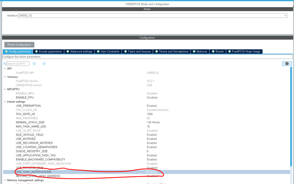

I want to ask how to use/implement the FreeRTOS task notifications (https://www.freertos.org/RTOS-task-notifications.html)?
I cannot find any of the CMSIS v2 API to use , even though I already enabled the USE TASK NOTIFICATION option in STM32CubeMX. I must use the v2 API since TouchGFX is using this too...
Any helps are appreciated!
