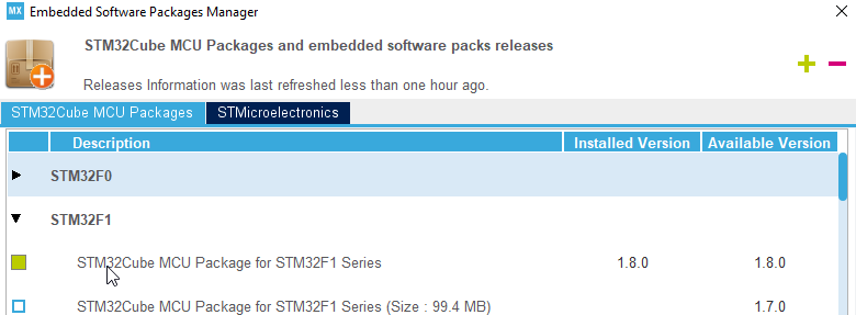

I use standard paths - nothing fancy. AV and Firewall are disabled during packeges installation. Below screenshots one after installation (succeeded), restart the program and again there (second screenshoot).
After restart Cube :

2019-09-04 10:33 PM
First screenshot could be it looking in a different repository directory.
2019-09-04 10:57 PM
How to check that directory ? And why once shows that they are installed once not? I just turned on CubeMX and saw one of the four packages installed. The same thing happened on version 5.2.0
