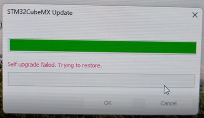

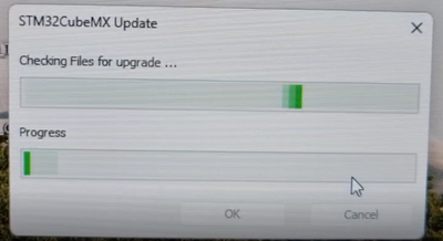

after start STM32CubeIDE_1.17.0 the IDE crash after 10-20 seconds.
- Im try start with admins -> same
- remove workspace .metadata -> same
- set different java in to path -> same
- reinstall IDE new -> same

2025-02-27 8:48 AM
update.
I make video from close session: problem in checking files for upgrade ...
Im install again new and start with admin -> same
what is here solotion ?

2025-03-28 5:26 AM
Hi maniek,
I had the exact same problem on STM32CUBEIDE ago. I saw your review with the images you posted, so I guessed that the problem is the updates STM32CUBEMX. In fact, the day before I had updated the version of STM32CUBEMX but then I had only turned it off and not restarted. I did it now and STM32CUBEMX completed the pending updates and when I started STM32CUBEIDE it stayed on ,it doesn't shut down and works as before.
So I suppose the solution is to have the updates on STM32CUBEMX that are pending complete
ps.you did well to make the video and post pictures. Without these I would never have understood it.
