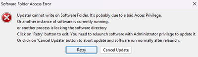

All the Updater says is "Self Upgrade failed. Trying to restore" then crashes.
I tried a few things such as creating a new workspace, disabling auto updates, offline mode, reinstalling, deleting plugins, etc...
2024-09-20 6:57 AM - edited 2024-09-20 6:58 AM
Same story here, however in my case appears cubeMX update may have caused this.
So now for any of the STM suite software to launch requires admin privilege. This is new.

Run it as administrator.
2025-06-01 2:04 AM
I resolved with this issue by update the cubeMX to latest version. I do resloved
