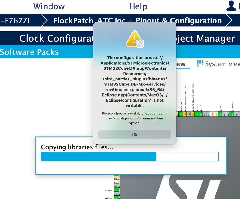

Anyway, once you finally get everything installed and generate code, you get:
Indeed the directory in question is:
drwxr-xr-x  4 root  admin  128  5 Jul 12:12 configuration//
not writable by anybody but root. Why root? Because we had to install as an administrator. See part 1.

Hello @Andrei Chichak
I made the test with a MAC 14.5 machine and I was not able to reproduce the same behavior.
Could you start STM32CubeMX via terminal and share the content of the terminal.
