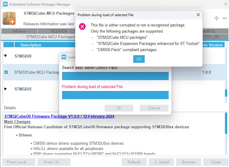

STM32CubeIDE 1.15.1 login error, although Check Connection shows "green" in the "Firmware Updater". Because of the Login error I cannot Install "STM32CubeU0 Firmware Package V1.0.0 / 12-February-2024".
I have seen in the Forum, that this kind of error has been around for a while, and even with this (for the time being) latest version of STM32CubeIDE.
If some of you fellows have working ideas, please let me know!

2024-05-15 10:52 AM
I have same problem. Any solutions?

Hello @miga
I need to ask if your PC is connected via a proxy. If it's the case, are CubeIDE's Network settings well set.
Check this article for more details : How to set the network connection parameters for S... - STMicroelectronics Community
KR,
Semer.
2024-05-16 3:38 AM
Hi Semer CHERNI,
thank you for your answer!
I have already tried similar methods over and over again since yesterday.
2024-05-16 7:15 AM
Hello @miga
Was you able to connect to your account on st web site to download the package?
STMicroelectronics: Our technology starts with you
2024-05-16 7:50 AM
Hello Semer CHERNI,
thanks again for answering!
In my Edge browser I am currently writing this message, and was thus able to log into the ST community.
I was also able to find and download "en.stm32cubeu0-v1-0-0.zip" from
https://www.st.com/en/embedded-software/stm32cubeu0.html#tools-software,
and tried to install it from my "Downloads" directory. The bad result was in the snippet picture I posted abowe.
(I was even able to unpack the ZIP.)
2024-05-16 9:48 AM
Hello @miga
I need you to make some other tests.
Could you try with STM32CubeMX as standalone application.
If the same behavior is faced, could you send me the STM32CubeMX log file found under .stm32cubemx folder.
KR,
Semer.

2024-05-21 6:31 AM
Hello Semer and Jacob WooDruff
On Friday 17-May-2024 I sent the email text below to notification@communitymailer.st.com, as a response, after the error disappeared without my interference...
Hello Semer,
Thanks a lot for your help, :smiling_face_with_smiling_eyes:
the issue on your server seems to have fixed my errors, and I can login and have installed the
"STM32CubeU0 Firmware Package V1.0.0 / 12-February-2024"!
How can I tell the community that you solved the bug?
