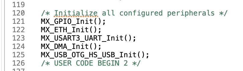

The MX generated C code issues the USART initiation call before the DMA initiation call. My code simply echoes back any text received by the USART. Unfortunately the echoed data (correct length) is all zeros. The UART read buffer is initialised with zeros.
The issue is resolved by simply placing the DMA initiation call before the USART initiation call!
What’s going on? Looks like the DMA code upsets something set by the USART code, but what?

The UART initialization modifies a DMA register, which needs the DMA clock to be active. The clock is activated in the DMA initialization.
For what it's worth, CubeMX generated the correct order on a fresh project for me. It's possible you're not on the latest version or something else is going on.

Thanks for this TDK. I assume from your response that in certain cases, such as this one, the sequence of initiations is critical. Are you able to tell me just why that is the case here; a casual look at the generated code doesn’t provide any obvious answers.

That’s an excellent answer, thank you TDK. I’m using CubeIDE v 1.7.0 which is the latest version so something else must be at play!

FYI, TDK: The above was code generated by CubeIDE v 1.7.0 for a Nucleo-H723ZG. The only thing I did to the default configuration was to add DMA receive to the USART!
