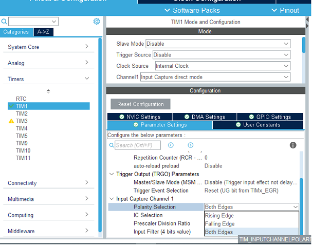

In certain STM32 MCUs input capture can be defined for both falling and rising edge.
In such cases, how to know if the input capture interrupt routine was called due to a falling or a rising edge? Is there a way to know?

There's no direct way.
But you can simply read the current state of given pin from respective GPIO_IDR, If you know that the input signal won't change too fast.
