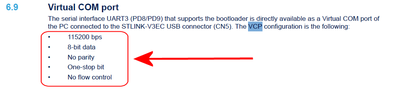

Is it this part that you're asking about:
Those are just the settings that you'd need for any UART link.

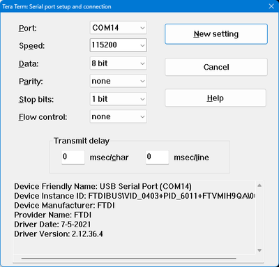

For example, in TeraTerm:

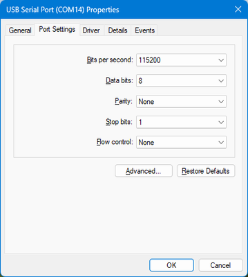

In Device Manager:

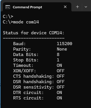

Or at a "DOS Prompt":
So all exactly the same as you would for a real COM port, or any other USB-to-UART device (FTDI, in the above examples).
