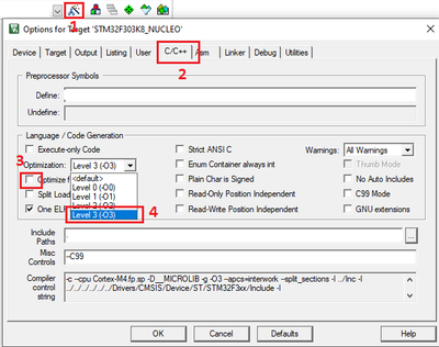

2024-04-23 8:23 AM
To optimize on size click the buttons on these steps.
On Step 3 you need to uncheck the box "optimize for time".
Does it answer your question?
