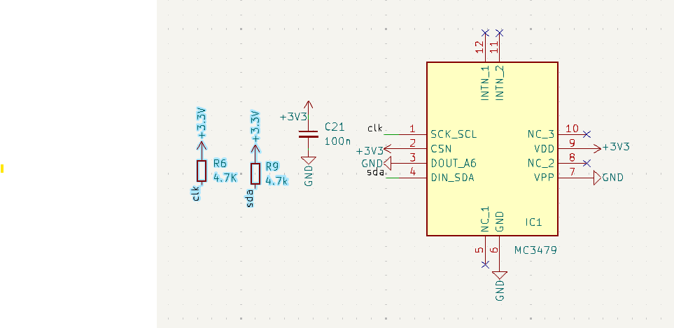

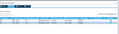

What's the first bit map of.code fragment about?
Probably issue not where you're looking.
State slave part and connectivity.
Don't use internal pull up on AF OD. Use an external pull up likely in 1K5 to 2K7 range.

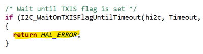

"if (I2C_WaitOnTXISFlagUntilTimeout(hi2c, Timeout, Tickstart) != HAL_OK)
return HAL_ERROR;
this function is come true.
2024-04-22 12:25 AM
@SMazu.3 , what i dont understand :
you call (blocking) HAL_I2C_Master_Transmit() , that will return success or error
and then (i assume - you dont show your program) I2C_WaitOnTXISFlagUntilTimeout() to check --- what ?
TXIS flag ?
-> transmit interrupt status : but you dont use interrupt call at all.
I would say: just leave it away or use interrupt I2C calls.

2024-04-22 12:47 AM

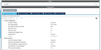

already using 4k7 with 3v3
2024-04-22 12:53 AM
default i2c setting.
2024-04-22 5:06 AM - edited 2024-04-22 5:18 AM
MC3479 It's MEMSIC accelerometer
I2C: supports 400 KHz and fast mode +. Has two interrupt pins with programmable mode/polarity.
The 7-bit address can be 0x4C or 0x6C (see the PDF pg, 35).
2024-04-22 5:50 AM
hw is working i test that with Arduino and esp32 and esp8266,
stm code is no working. WaitOnTXISFlagUntilTimeout come Hal_Error very time.

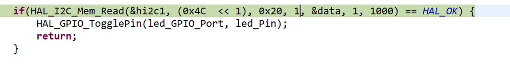

2024-04-22 5:58 AM
Consistency is good, it hints that you're doing something generally wrong for the ST library. Check that you pass the I2C address in correct format.
