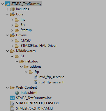

I'm expecting to find this in the STM32CubeIDE project view:
But this is what I really find:

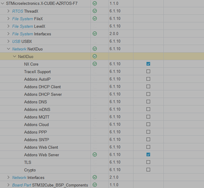

Regarding the selection of Netxduo FTP add-on, it was not specified inside the X-Cube-AZRTOS-F7 package (no specific bundle in the *.pdsc file). I guess it was estimated as not important. The files are still present in the repository though.
