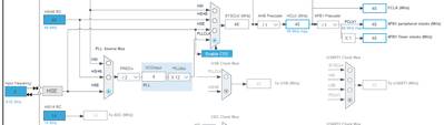

I tested like this and it still didnt work?

Oh I assumed teh 8Mhz crytsal on the nucleo was the HSE source. The board I was using is teh STM32F072RB NUCLEO-64
2023-12-05 9:17 AM
So why are you setting in the Cube Clock Tree Diagram to 32 MHz?? The HSE source from the ST-LINK/V2-1 MCO pin is 8 MHz
Make sure HSE_VALUE in the stm32xyz_hal_conf.h also reflects the clock source.

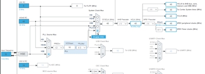

Hi guys thankyou for the help, @Tesla DeLorean you was right! I assumed the deafult configuration for the nucleo board would be set to match the on board crystal which was 8MHz (the default value was 32MHz). changing the input frequency for HSE as per the diagram below:
my CAN comms began to work, thankyou very much for the help guys, Im still learning about all this embedded stuff so I appreciate the time!
