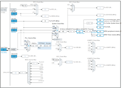

So why are you setting in the Cube Clock Tree Diagram to 32 MHz?? The HSE source from the ST-LINK/V2-1 MCO pin is 8 MHz
Make sure HSE_VALUE in the stm32xyz_hal_conf.h also reflects the clock source.

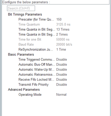

What settings on bus, prescaler, SJW, BS0, BS1, etc.

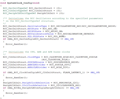

My Apologies!
Heres my CAN configuration settings:
Heres my clock settings:
Any help would be gretaly appreciated as I thought the extrenal clocks should be much more accurate however I can only get my CAN to work using the internal clock sources.

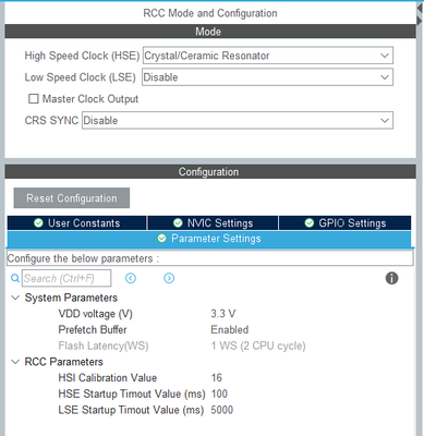

You're not showing the external clock settings

Hey Karl,
Is this what you mean?

2023-12-04 11:46 AM - edited 2023-12-05 9:17 AM
So a custom board?
32 MHz, show the part# and circuit. It can be off-frequency if incorrectly loaded.
Perhaps plumb the HSE out out the PA8 (MCO) and measure the frequency on a meter or scope.

No, your post of images is that of HSI settings which does no good when your main issue is with HSE not working. So post the HSE setup.
2023-12-04 8:20 PM
you should set clock to be HSE which it's 32MHz and it's difference from HSI 48MHz so You should adjust HSE by PLL to be 48MHz and use it as main clock.

2023-12-05 2:24 AM
