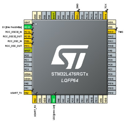

Clicking "no" to set up peripherals will leave your chip configured in the following state, with B1 and LD2 defined:
If you want absolutely nothing configured, start with the chip itself instead of the board or un-define those pins.

Ok my stupidity. I confused B1 (the blue user button) with PB1. Now it’s clear. Thanks
