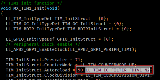

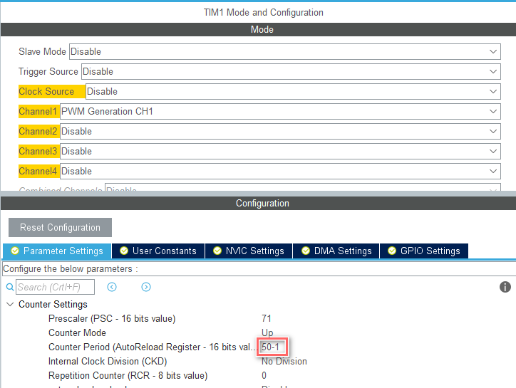

using stm32cubemx 6.0 to make a project for STM32F103RC TIM init.
the configuration as follow pictures.
the code be generated as a wrong as follow.

Hello Bruno Hu,
I can't reproduce the issue, could you please share your .ioc file for further check?
