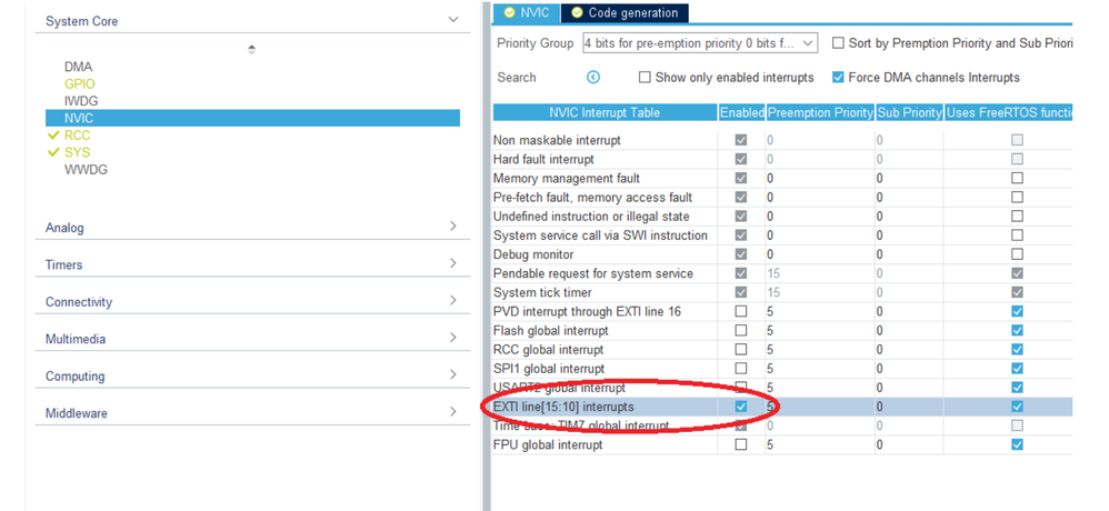

I initally configured a project with CubeMX 5 and after having configured the FreeRTOS, the NVIC configuration pages looked like that:
0693W000003PjUNQA0.png(Don't mind the red circle specially, it is an old screenshot). But the point is, there were a column to select if the interrupt will use some freertos functions and if so, it applies the priority level according to the parameter "LIBRARY_MAX_SYSCALL_INTERRUPT_PRIORITY" of your FreeRTOS", in my case, level 5.

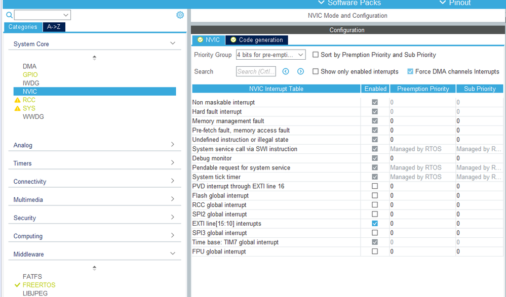

But now, there isn't anymore this column with this great feature with cubeMx 6 which is sad (see picture below)
But more important, in this same project, the priority as been modified without my will to 0 instead of 5.
Unless I am wrong, FreeRTOS API can't be called from interrupt with lower number (higher priority) than the parameter mentionned earlier.
So my project would't be working because of that. Happily for me, I didin't re generate the code, so the modification of the priority level was not applied.

According to this post it's fixed by version 6.0.1
Yes I confirm it, thanks @Community member​  for your quick answer.
