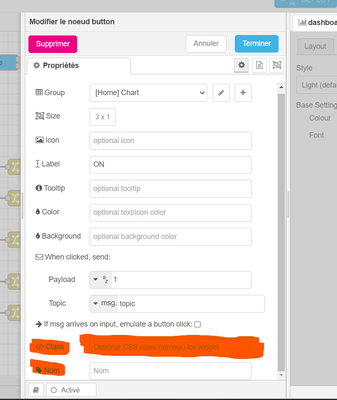

I would like to use a CSS class on stm32cubemonitor on a button or on some text. Do you have a tutorial or an example to use this option? Please.

Please have a look to Sample pretty buttons for node-red-dashboard (flow) , it gives a collection of templates nodes acting as button and customized through css class that could also be applied to text node.
Css class you highlight in the button node sounds not being working in the dashboard version used by CubeMonitor.
