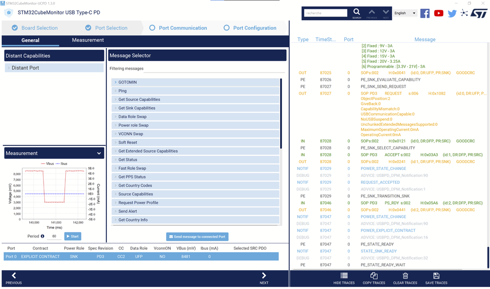

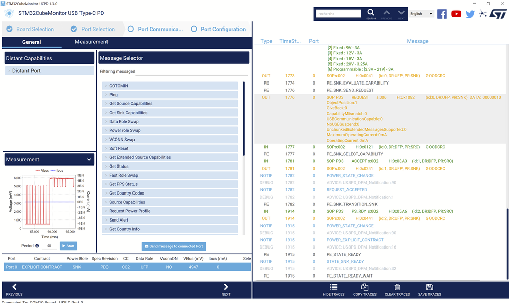

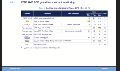

Hi FBL,
Thank you for your reply.
I try to build a 'PDO SINK' project on B-U585I-IOT02A and I have followed steps of 'STMicroelectronics.X-CUBE-TCPP_GettingStarted'.
On STM32CubeMonUCPD, 'ibus(mA)' value seems mixed with Vbus(mV). But I can't find where is TCPP03-M20's Iana_gain settings in the generated code.
I would appreciate it if you could let me know where is PD13 USB_IANA calculation in 'BSP_USBPD_PWR_VBUSGetCurrent' function and how to separate the trace in LPUART1 or ADC4.
Please find below screenshot and attached for your reference.
Best regards.
Robert

Hi @Robert7
Just to keep you informed, I am not an expert in TCPPxx, but you can find GPIO configuration of Iana on the TCPP0203_PORT0_IANA_GPIO_PIN in PWR_TCPP0203_GPIOConfigInit(). You can add debug prints to make sure you are getting correct values
