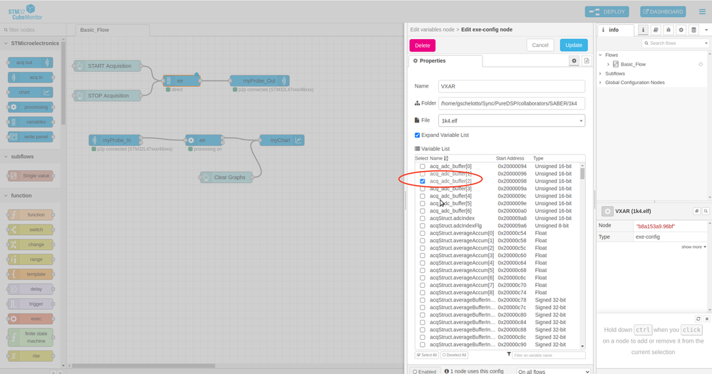

In order to get whole array, you need to select all of it variables in the variable node edition.
Upon executable config file edition, select "Expand Variable List" check box to be able to select them.

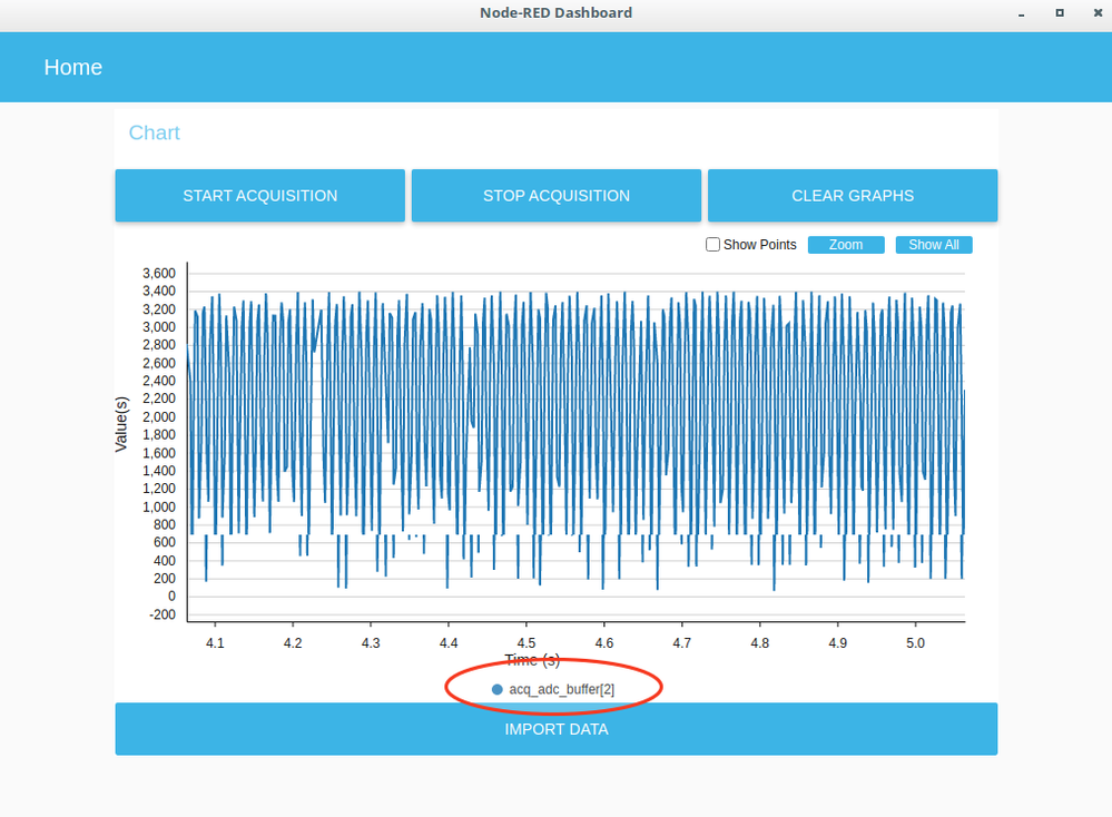

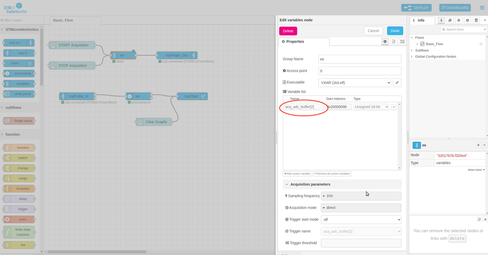

In my case I use a [7][256] uint_16 array and I need to acquire (for example) 256 samples of index 2 of this array located at &acq_adc_buffer[2][0] address. In STM32Cube Monitor I select this variable as shown:
But in the Chart I only get a single acq_adc_buffer[2][0] data, not the whole array of 256 samples.
Any idea?
