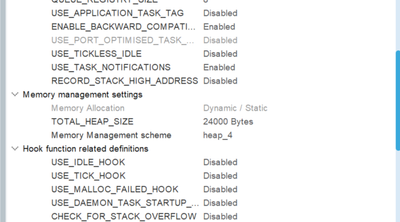

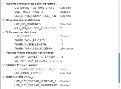

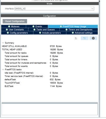

I've included the task initialization and process for both below. Additionally, I've attached my CubeMX configuration for the FreeRTOS system.

I am unfamiliar with FreeRTOS on a deep level, but I suspect it is related to memory management and/or the priority system of the tasks, but I am unsure of how to prove this and diagnose this problem. The reason I suspect it's a memory issue though is that I'm running at 94.61% of Internal RAM usage. I allocate the entire TouchGFX task and 480x272, RGB565 array in the Internal RAM, which is why it's so heavily used.

I'd would probably try to reduce RAM usage to see does it makes any difference. You can for example reduce vertical resolution in half and then maybe even move framebuffer to unused 128K block.
Since you earlier had problems with statically allocated framebuffer, it is likely that this problem is also related to memory usage. As long-term solution, you could consider to use partial framebuffer.
