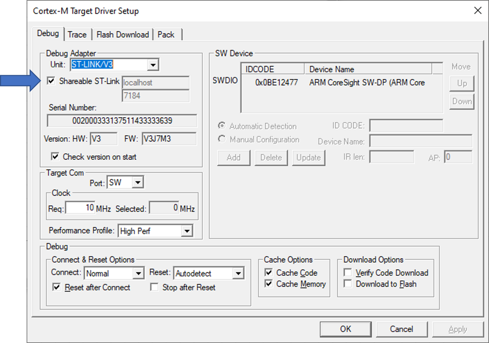

Hello
For the probe, STM32CubeMonitor do not support the uLinkPro probe, but the ST-Link v3 availaible on the STM32L562E-DK is supported.
The tool can be used with uVision, the axf file can be used as executable file to list symbols. There are 2 options : use tools in sequence, or use at the same time :
Please, let me know if it is clear or if you need additional information.
