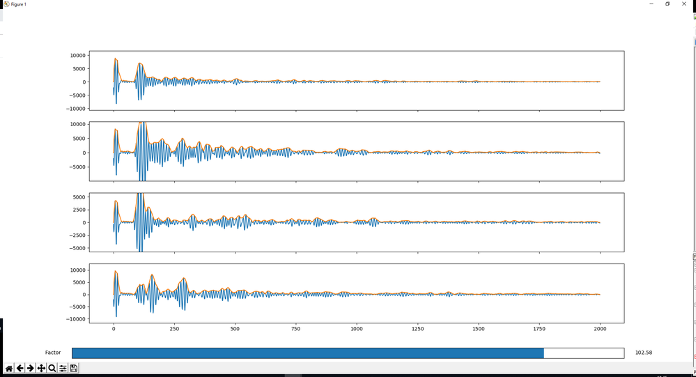

2020-03-31 10:18 AM
Here is a screenshot from my debug Python script. It would be greate to have something like this in CUBEMonitor.

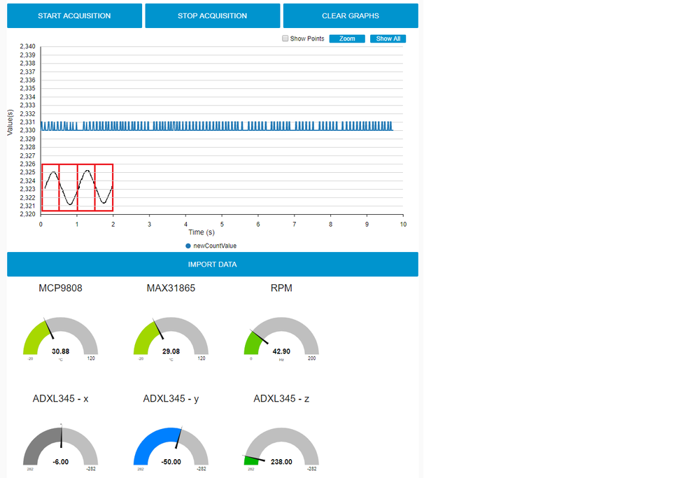

2020-03-31 10:31 AM
For my situation:
Create a new "variables" node. Add the whole array and set in the "Acquisition paramters" = Sampling frequency e.g. 2Hz.
(For me it means, that the array will be read out every 500ms).
On the "chart" the data values in the array will now be ploted every 1/2 second, like you can see in the image.
(The content in the red boxes are the data values, the red boxes are the 500ms time windows.

Hi KChiz.1,
You have 4 charts in your screenshot, that's it means 4 different 1D arrays ? or it's the same array at different times ?
If it's different times for the same array, how do you want to define this ?

2020-04-06 12:48 AM
Hi PSchm.1,
If I understood well your demonstration, we need to create "artificial" x values each time we read the buffer for each value in this buffer, depending of the acquisition frequency , to "fill" the time of the period of acquisition .
So it can lead to show in the graph a value read in "reality" at 0 to be displayed "artifically" in your example at 0.499 ?
I'm asking you just to be sure i understood your need, we need to provide something useful for everybody.
