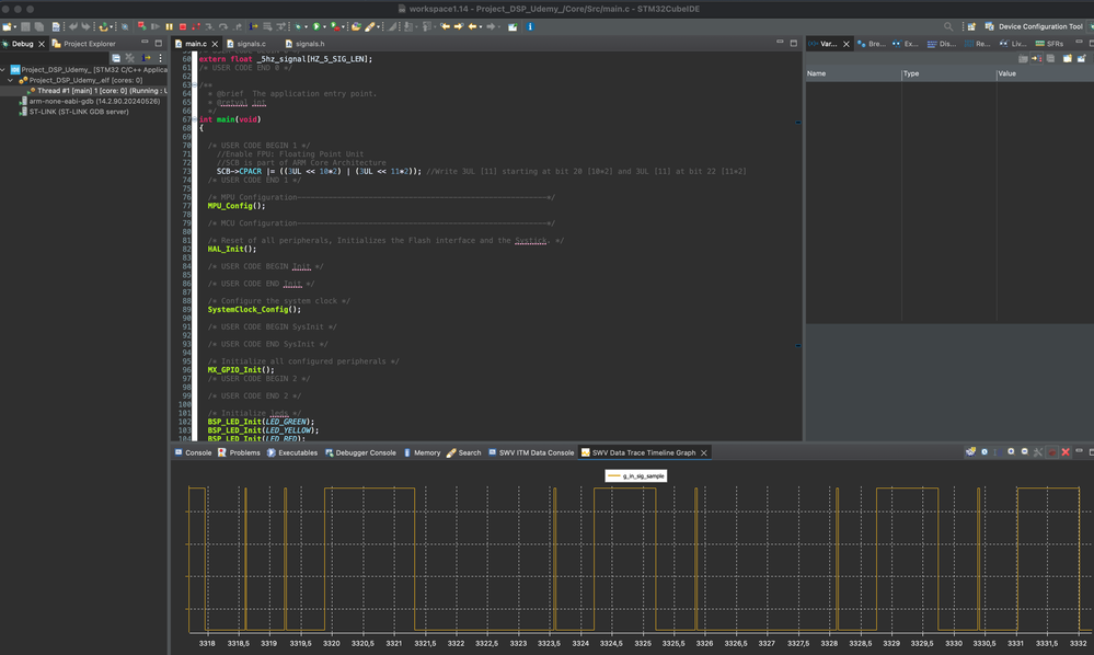

I am making use of the SWV to plot a 5Hz Sine Wave.
The output on the plotter does not resemble a sine wave:
Any recommendations to fix this?

How did you set the scala ?

Are you sure that the data being sent actually represents a sinewave?
Have you tried sending the data over a UART, and capturing in a terminal?
Please show your sinewave generation code
How to insert source code
Function I am calling in while loop inside main.c
  static void plotInputSignal(void)
	  int i;
	  for (i = 0; i < HZ_5_SIG_LEN; i++)
		  g_in_sig_sample = _5hz_signal[i];
5Hz samples (301):
float _5hz_signal[HZ_5_SIG_LEN]=
	0,0.30902,0.58779,0.80902,0.95106,1,0.95106,0.80902,0.58779,0.30902,1.2246e-16,-0.30902,-0.58779,-0.80902,-0.95106,-1,-0.95106,-0.80902,-0.58779,-0.30902,-2.4493e-16,0.30902,0.58779,0.80902,0.95106,1,0.95106,0.80902,0.58779,0.30902,3.6739e-16,-0.30902,-0.58779,-0.80902,-0.95106,-1,-0.95106,-0.80902,-0.58779,-0.30902,-4.8986e-16,0.30902,0.58779,0.80902,0.95106,1,0.95106,0.80902,0.58779,0.30902,6.1232e-16,-0.30902,-0.58779,-0.80902,-0.95106,-1,-0.95106,-0.80902,-0.58779,-0.30902,-7.3479e-16,0.30902,0.58779,0.80902,0.95106,1,0.95106,0.80902,0.58779,0.30902,-2.6955e-15,-0.30902,-0.58779,-0.80902,-0.95106,-1,-0.95106,-0.80902,-0.58779,-0.30902,-9.7972e-16,0.30902,0.58779,0.80902,0.95106,1,0.95106,0.80902,0.58779,0.30902,1.1022e-15,-0.30902,-0.58779,-0.80902,-0.95106,-1,-0.95106,-0.80902,-0.58779,-0.30902,-1.2246e-15,0.30902,0.58779,0.80902,0.95106,1,0.95106,0.80902,0.58779,0.30902,-2.2056e-15,-0.30902,-0.58779,-0.80902,-0.95106,-1,-0.95106,-0.80902,-0.58779,-0.30902,-1.4696e-15,0.30902,0.58779,0.80902,0.95106,1,0.95106,0.80902,0.58779,0.30902,-1.9607e-15,-0.30902,-0.58779,-0.80902,-0.95106,-1,-0.95106,-0.80902,-0.58779,-0.30902,5.3909e-15,0.30902,0.58779,0.80902,0.95106,1,0.95106,0.80902,0.58779,0.30902,5.3897e-15,-0.30902,-0.58779,-0.80902,-0.95106,-1,-0.95106,-0.80902,-0.58779,-0.30902,-9.0649e-15,0.30902,0.58779,0.80902,0.95106,1,0.95106,0.80902,0.58779,0.30902,5.6346e-15,-0.30902,-0.58779,-0.80902,-0.95106,-1,-0.95106,-0.80902,-0.58779,-0.30902,-2.2044e-15,0.30902,0.58779,0.80902,0.95106,1,0.95106,0.80902,0.58779,0.30902,5.8795e-15,-0.30902,-0.58779,-0.80902,-0.95106,-1,-0.95106,-0.80902,-0.58779,-0.30902,-2.4493e-15,0.30902,0.58779,0.80902,0.95106,1,0.95106,0.80902,0.58779,0.30902,-9.8096e-16,-0.30902,-0.58779,-0.80902,-0.95106,-1,-0.95106,-0.80902,-0.58779,-0.30902,4.4112e-15,0.30902,0.58779,0.80902,0.95106,1,0.95106,0.80902,0.58779,0.30902,6.3694e-15,-0.30902,-0.58779,-0.80902,-0.95106,-1,-0.95106,-0.80902,-0.58779,-0.30902,-2.9392e-15,0.30902,0.58779,0.80902,0.95106,1,0.95106,0.80902,0.58779,0.30902,-4.911e-16,-0.30902,-0.58779,-0.80902,-0.95106,-1,-0.95106,-0.80902,-0.58779,-0.30902,3.9213e-15,0.30902,0.58779,0.80902,0.95106,1,0.95106,0.80902,0.58779,0.30902,-7.3516e-15,-0.30902,-0.58779,-0.80902,-0.95106,-1,-0.95106,-0.80902,-0.58779,-0.30902,-3.429e-15,0.30902,0.58779,0.80902,0.95106,1,0.95106,0.80902,0.58779,0.30902,-1.238e-18,-0.30902,-0.58779,-0.80902,-0.95106,-1,-0.95106,-0.80902,-0.58779,-0.30902,-1.0779e-14
Thank you for the suggestion. Tried it, but it does not work unfortunately.

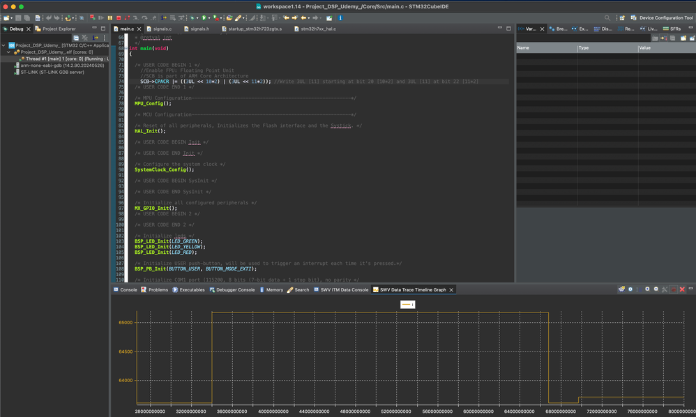

In this example I am incrementing a variable in the while loop with a delay of 500ms.
