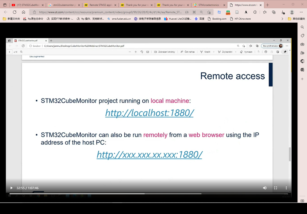

I have watched this video many times before, and my understanding is that the host, mobile phone and ipad are in the same local area network. Even in the same local area network, other devices still cannot connect to the host address (ipv4), is there any configuration required for the router (but I can ping my computer with other computers, when I enter http://Ip address:1880/ , no dashboard found).:face_with_tears_of_joy:
Is there anything special about this configuration in the picture?

There is no special configuration in the picture, we just use it to see the IP address.
