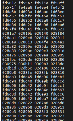

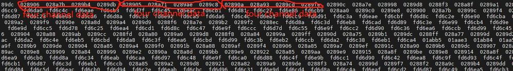

2022-10-05 7:12 AM
Thank you.
I am collecting external ADC data, and then inputting it through serial port. 24bits is one channel data, every four is a group(as figure shows). I want to chart the data for each channel, and have the four channels simultaneously do the waveform drawing in real time.
Do you have any relevant examples?
2022-10-05 8:04 AM
Sorry, I do not have any ready-made example.
I can advise you to use a function node, loop through the elements, store each group into a temporary array, convert the array in JSON format.
Thank you to mark my post as answered.

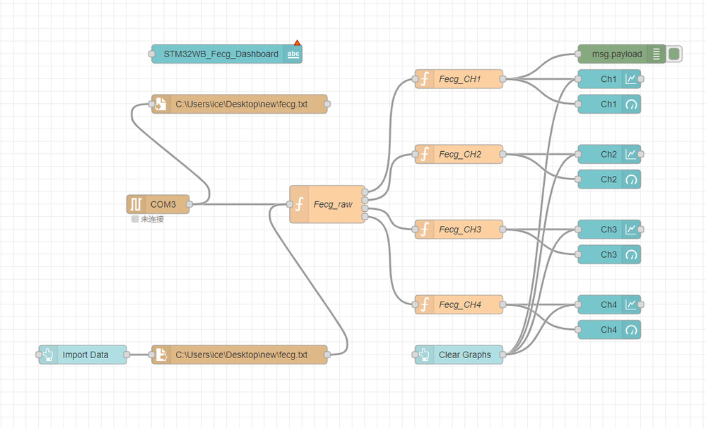

2022-10-12 4:04 AM
Thanks again for your help.
Recently, I learned javascript and node red once, and I have basically completed my functions. You have given me a good start to face these problems.
And I have a new problem. I want to display dashboard in my phone, ipad and computer website. What should I do?
