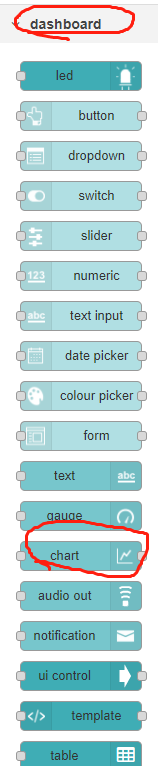

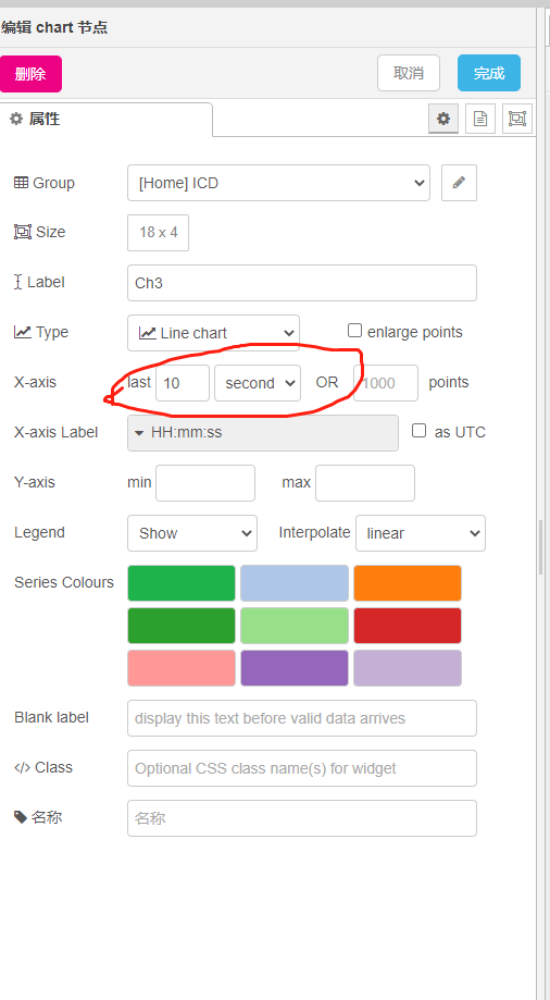

I just want to display 10s data, but the chart records every 10s data ,,the chart display many 10 second data.
2022-11-17 4:11 AM
Hi @�?� 丫饼
Looks like you're using the node red default chart, not the ST specific one. May be you can find a node complying your need in the available nodes on the web. STM32Cubemonitor is only providing a limited list of nodes.
