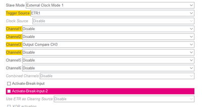

I'm using a NUCLEO-311RE board.
I'm looking for a way to bypass the external waveform as it is.
This is my timer setting

In this way, a waveform with a frequency of 1/4 of the external waveform is generated. Is there another way to copy the external waveform as it is?

2025-07-15 7:57 PM
> NUCLEO-311RE
There is no such board. Maybe NUCLEO-F411RE?
Use a buffer amp or op-amp in follower configuration.
Can't have a channel output from a timer be the same as the input clock.
2025-07-16 1:53 AM - edited 2025-07-16 1:55 AM
@giwonKIM wrote:Is there another way to copy the external waveform as it is?
As @TDK said, no - but why do you want to do that?
If you say what you're actually trying to achieve, people may be able to offer other suggestions ...
