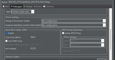

Hii Everyone, I am trying to debug with SWO and SWV in STM32CubeIDE with NUCLEO-H753ZI. But, I am not getting any prints on SWV ITM Data console. As you can see all settings in the below attachments. My CPU system clock is running at 400Mhz. Anyone suggest me to get prints in SWV/ITM Data console.

I have followed same procedure as mentioned in this document AN4948. But I didn't get any prints.

Thank you your reply, I did same thing as you said. But I didn't get any prints.
