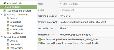

what did you set : in project settings ->

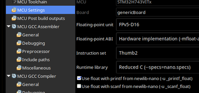

2024-04-17 10:51 AM
I guess I could uncheck the scanf option since it is not used. But that does not make a difference.
I already did the break point on the sprintf line. The float values are good and the string after the sprintf has the garbage characters in it. I also tried stepping into the sprintf function but it simply steps over it. The local string buffer is initialized to all 0 upon entering the routine containing the sprintf.
